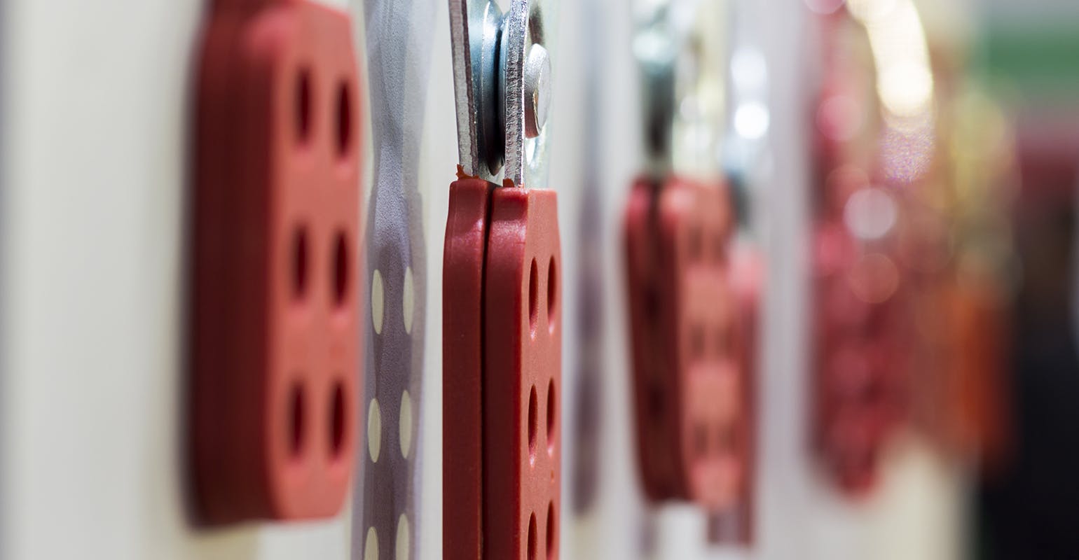

Warut Sintapanon | Dreamstime
Machinery lockout devices.
