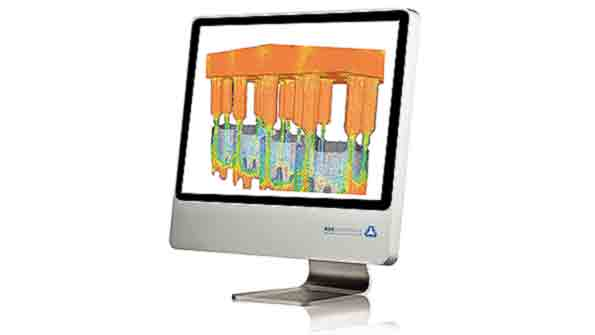

Fortunately, our services are geared toward perfecting development long before production. Take core box design, for example. We will optimize the blow tube and vent design using state-of-the-art computer simulation software. This allows a foundry to maximize its productivity, reduce scrap and optimize raw material purchasing. It’s a win-win scenario.

Arena-Flow® software is a computational particle fluid dynamic technology (CPFD). It enables you to accurately predict and optimize core box tooling design and the core making process by evaluating core density, core blowing and curing cycle times in a virtual, 3D world. In fact, I would have to say it’s undoubtedly the most accurate software available in the market place today. We knew, some years ago, how valuable realistic core shooting software could be to a foundry. From a technical standpoint, it simulates granular sand motion and air within the tooling, as well as the interaction between the two. No other software on the market today has this capability.
The result is an extremely realistic and accurate simulation that inevitably leads to greater production efficiency and less scrap. We are really proud to have this in our portfolio. It certainly always impresses our customers when they see it. Honestly, their excitement never gets old to me. You can just see them thinking about how much they’ll save on tooling start-up costs, scrap and tooling design. It’s nice to offer something with so much upside!
