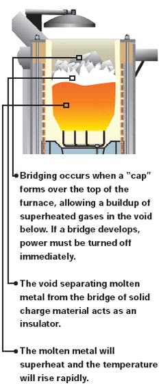

Bridging
When charge material in the top portion of the furnace is not in contact with the molten metal below it, the dangerous condition known as bridging exists. When bridging occurs, charge material is no longer serving to moderate the temperature of the bath during the melting cycle. Also, the air gap between the molten metal and the bridge acts as an insulator. The molten metal below the bridge, under the impact of full melting power, will superheat.
This superheating in an induction furnace will occur very rapidly and will raise the temperature of the molten bath above the maximum temperature rating of the refractory. Also, excessive metal stirring below the bridge, due to the small metal mass and high power density, will combine with the high metal temperatures to cause rapid lining erosion or possibly complete refractory failure.
Without immediate attention to a bridging condition, a run-out due to refractory failure may occur. If the run-out is through the bottom of the furnace, it can cause a fire under the furnace and in the pit area resulting in a loss of hydraulics, control power, and water cooling. (Be sure to keep the furnace pit area clean and dry. Do not allow water or hydraulic fluid to accumulate in the pit. It is designed to hold molten metal in case of an emergency and must be kept clean and dry.)
If the run-out is through the side of the furnace, the coil may be compromised and when cooling water comes in contact with the molten metal, the water instantaneously turns into steam. If the water becomes trapped by the molten metal, this instantaneous expansion may produce an explosion which could cause injury or death and extensive damage to equipment. Bridging can occur in any induction furnace. All furnace operators must be able to recognize bridging and its dangers and know how to solve a bridging problem.
Bridging can be minimized by using proper charge material and by making sure the different sizes of charge material are added correctly. If a bridge occurs, power must be turned off and the melt deck and surrounding areas evacuated immediately until enough time has elapsed to allow the molten metal to solidify.

Warning Signs of Bridging
Bridging may reveal itself with several warning signs. The clearest warning sign that bridging has occurred is that the melt is taking longer than calculated. Rather than increase the power, the operator should switch off power immediately. Under no circumstance should the operator increase power.
If ferrous metal is being melted, the chemical reaction which it creates on contact with the furnace lining will, under superheated conditions, produce carbon monoxide. This gas may reveal itself as small blue flames on or in the bridge. The appearance of these flames indicates the bridge may be pressurized, and it must not be breached.
In the case of a nonferrous charge, gas production will also occur, but there are no flames or other visible indications of its presence.
