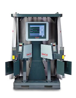

SinterCast’s third generation of process control technology for CGI is available in two systems: the System 3000 (left), which will be deployed at Cifunsa; and MiniSystem 3000 (right), which has been license by China’s FAW Foundry Co. Ltd.

System 3000 is modular, like its predecessor, so it’s flexible enough to be installed for any foundry or process flow. It can be configured for foundries that produce CGI from pressurized pouring furnaces or by ladle pouring.
The new hardware platform is based on an industrial computer with a solid-state hard drives, and includes power filtration to protect against surges or brownouts. Operator interfaces are displayed on a 19-in. touch-screen display, custom programmed in the local language and configured to each foundry’s preferences. System 3000 also has hardware diagnostics and troubleshooting functions that are accessible via a laptop link-up to one of the serial ports.
