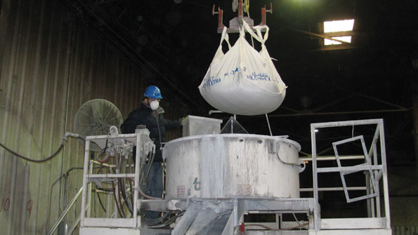

In 2012, Riverside approached Blastcrete about developing a mixer that could be used for both dry and wet blending in the company’s precast operations. It also wanted a mixer that could process small batches efficiently, as well as batches greater than 2,000 lbs.  At the time, Riverside used a non-tilting, flat-mounted mixer that made small batch production difficult, and wasted material and time.
“Riverside needed to dry blend because when they batched their raw materials, they had to bypass their standard, castable mixer, particularly with small batches for their precast plant,” recalled Blastcrete president Jim Farrell. “Changing formulations in refractory mixing requires complete cleanup, which can take up a lot of time. Riverside could avoid that by being able to batch then blend the dry materials, and after that add water in the same mixer.”
Blastcrete’s 2,200-lb. hydraulic pan mixer fit Riverside’s needs. It blends as little as 200 lb. of precast material in its hydrostatic pan mixer, and it offers other benefits too. A bottom-discharge point allows operators to dispense a finished mixture through the bottom into a storage container or another transportation vessel. Adjustable, telescoping legs extend or shorten the pan mixer’s height. Retracting the legs allows the unit to fit under different ceiling heights, while lengthening the legs permits greater access to the discharge point.
The 15-sq.ft. platform provides a spot for the operator to observe the mixing process, and accurately measure volumes of water, using the Fill-Rite water meter. If the mixer needs to be moved, a forklift operator can safely pick it up using the forklift pick-up points on the bottom of the mixer.
During the mixer’s first use, the Riverside operators realized that if the existing 40-hp electric motor’s speed could be increased, they could use the same machine to mix and bag castable material (when required) outside of the precast operation. Based on that insight, Blastcrete modified the design to mix faster and with more torque for dry blending.
