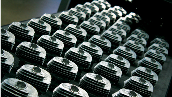

Husqvarna chainsaw aluminum cylinder blocks, ready for finish machining.

In Huskvarna, Sweden, the diecasting and machining operations at Husqvarna Group’s extensive manufacturing facility produces multiple different aluminum and magnesium castings for the group’s line of power tools, including crankcases, flywheels, cylinders, oil pumps and clutch covers. It uses a multiple processes (melting, casting, machining, honing, and painting) before assembling the parts into finished products.
