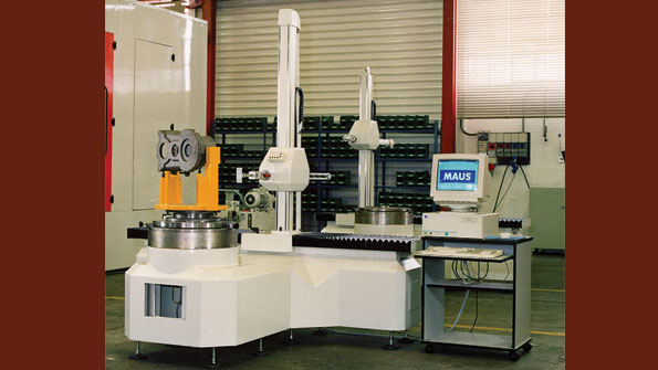

Palmer Maus North America offers a CNC automatic grinding platform that allows foundry workers to program parts with off-line technology while the production continues. This CNC comes with a compact, off-line programming bench that can be set in an isolated office or lab, which is more conducive to the concentration requirements of programming. The programming bench has a pedestal to place the fixture holding the finished casting, an arm that holds the simulated grinding tools, and a place to hook up a computer.
The proprietary software allows the programmer/operator to take the arm holding the tool to the area on the casting where grinding is desired and, while the tool is moved from point to point, the computer collects (i.e., downloads) each grinding location point to the program. When this is completed (usually a one to three hour process), the programmer simply places a thumb drive into the computer, downloads the program, takes the thumb drive to the CNC machine, installs the program to the machine, runs one or two castings to make adjustments, and saves the program to the machine.
The program also can be saved to the company server as a backup system. The relatively simple process is easy for most employees to learn, assuming that he or she possesses a very basic understanding of computers. More than that, this simplicity expands the pool of qualified employees.
