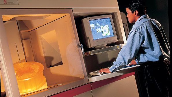

3D Systems is among the technology developers to have emerged in the recent expansion of additive manufacturing as an industrial sector. Its stereolithography machines represent one type of additive technology finding a place in more traditional manufacturing operations, like foundries or machine shops.
