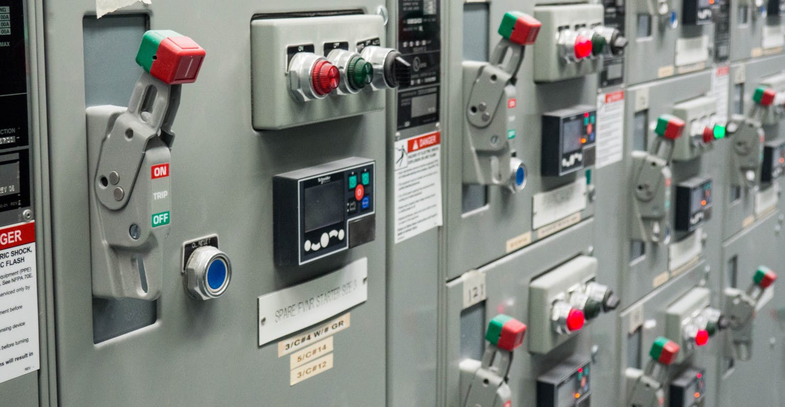

Manufacturing plant motor control center.
