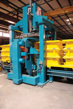

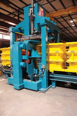

Sand Fill Hopper and Rain Gate — The sand fill hopper has been developed to ensure consistent use of the media. Previously, the correct amount of media was achieved either by weight or by time. The new, patented system precisely controls the media by volume, which guarantees consistency in the correct amount of media to be delivered to the flask.
Sand Fill and Compaction — Equipment for raining the media around the cluster must be precisely controlled and must be interlocked with the compaction system. The patented rain gate operates in three modes: fast, slow or stopped.
Vector-Flo® Compaction System — The new, patented Vector-Flo® Compaction Table System provides advanced control of media flow and compaction, which can be altered to fit each part and with precise repeatability. The compaction system uses four motors with a clamped flask, allowing the vibratory motor vectors to be adjusted to accommodate various programs of differing recipes while filling the flask with media. In fact, we can now ensure that sand flows “uphill” to completely compact blind holes, even at the base of the foam pattern. (We can arrange for a test unit to try the process for your product, so that customers can carry out detailed tests.)
