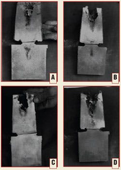

Figure 1: Differences in alloy segregation in steel test castings based on breaker core size and shape: A) 40% round sand breaker; B) 50% round sand breaker; C) 70% round sand breaker; D) sand star breaker.

Alloy segregation and under-riser cracking is usually only a problem when breaker cores are used to facilitate the removal of the riser. Earlier work showed that breakers with openings less than 70% of the riser diameter could cause segregation in the casting. However, new tests conducted by ASK Chemicals have shown that using different materials and geometries for the breaker core can minimize segregation while improving riser removal.
Aluminum pickup into the riser and casting from exothermic feeding aids is a serious concern because of the potential to produce aluminum nitride (AlN), which is known to embrittle steel castings. Tests were conducted to quantify the amounts of contamination from different types and formulations of feeding aids. Test cube castings were produced with different riser sleeve materials, and then the risers and castings were sectioned and local chemistry was analyzed, and the following conclusions were drawn:
• Alloy segregation can occur under the riser if the size of the opening, geometry and breaker core composition are not controlled or designed for the casting being fed (see Fig. 1.)
• The star breaker core design offers an improvement in the break-off of the riser from the casting and an apparent improvement in the feeding of the casting without alloy segregation compared to standard round breaker cores of the same cross-sectional area.
• The sand breaker cores are not as thermally transparent as previously believed. The size of the sand breaker core opening will affect its overall performance, which is dependent upon the chemistry of the metal and the geometry of the casting.
• Exothermic breaker cores can offer improved feeding through a smaller opening as compared to a sand breaker core. They can result in easier riser break-off and cleaning of the casting.
• Mathematical calculations show that a star breaker core design will be about 21.5% easier to break-off than a round breaker core where both cross-sectional areas are the same.
• Modeling can be an effective tool for determining the performance of your riser and breaker core design even before the first casting is made.
• Hot topping materials showed varying results. The degree of contamination depends on the formulation of the hot topping material.
ASK Chemicals reviewed the effects of the breaker cores and their overall performance in feeding a casting, from the size of its opening, to the materials it is made from, and to the shape of its contact area (see Fig. 2 on the comparison of fraction liquid between a 50% round sand breaker core and a similar sized sand star breaker core.) This provides evidence that the star breaker core design can improve the thermal profile at the contact area and reduce alloy segregation as the casting solidifies.
