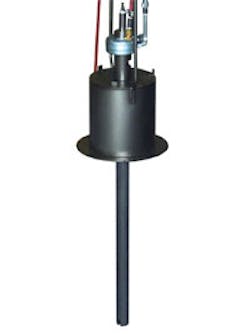

Palmer’s portable rotary degasser works on the principle of increasing the surface area of an inert gas exposed to the metal: The greater the surface area, the faster the degassing will be.
One of the products recently introduced by Palmer Manufacturing is a portable rotary degasser that offers efficient operation at low cost for aluminum foundries. By operating with dry nitrogen or argon, the degasser eliminates the need to use hazardous degassing tablets, or chlorine or Freon gases, to evacuate hydrogen gas from the molten aluminum. Also, nitrogen or argon is far cheaper to use than specialty gases.

Palmer recommends the use of dry nitrogen or argon with this degassing unit. Compatibility with specialty gasses cannot be guaranteed. With the exception of the graphite lance, every part of the unit that will be exposed to the gas is made of stainless steel or Buena-N (seals).
The Palmer Portable Rotary Degasser is powered by a -hp motor operating at variable speeds up to 3,600 rpm. The unit mounts either a 24- or 36-in. lance. The unit’s stainless steel body is 8 in. in diameter and 17 in. long. A mounting hook extends 14 in. above the body. Total weight is less than 50 lb.
The system is supplied with a combination air regulator-filter-lubricator for the air motor, and four standard lances. Prospective operators need only to provide a compressed air source at 90 to 120 psi, an overhead hoist, and a system with pressure regulator to provide nitrogen or argon gas.
The one-piece lance reduces cost by eliminating the shaft/impeller design used on some other degassing systems.
The degasser can be used for dip-out or crucible furnaces with capacities ranging from 40 to 3,000 lb. Degassing time estimates range from 1-5 min. for a crucible in the 70- to 500-lb range up to 5-10 min. for a 500- to 3,000-lb crucible.
The portable rotary degasser has a unique one piece lance, reducing cost due to the elimination of the shaft/impeller design. Portable and lightweight (under 50 lbs..), it also eliminates the use of hazardous degassing tablets and chlorine or Freon gasses.
