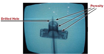

An x-ray revealed the nature and location of the defect in the original part.

With no previous knowledge of the problems with the part design, or product defects, Littler used simulation with Flow-3D to pinpoint the defects. They discovered that porosity problems were happening in two locations in the switch — a finding that was confirmed later by the customer. Holes were forming in the plate and the chimney because of the way the die was filling.
In addition, Littler engineers found through the simulation that there was a large amount of die erosion around the slot for the lock washer and the sealing surfaces on the bottom of the plate. Also, overflows located at the corners of the part were not large enough to allow oxides and air to flow out of the die.
