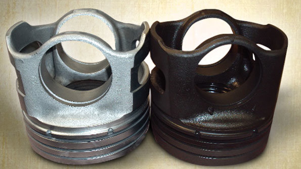

Samples of complex castings produced by the speed-controlled centrifugal process, developed by Gravcentri (U.S. Patent No. 8,186,417 B2.)

Metalcasters seeking a no bake process that offers excellent material properties with reduced scrap rates and a relatively low capital investment should take a close look at developments in centrifugal casting. Recent advancements in the centrifugal casting process make it an ideal choice, especially for reducing the cost of complex castings versus traditional conventional casting processes.  With this new process, molten metal is introduced into the cavity by combining gravity feed and centrifugal force feed using a variable-speed rotating turntable under electronic control. The centrifugal force is controlled, making it substantially more consistent until the metal has solidified.
Centrifugal casting is an option for producing complex geometries with less waste and better energy efficiency.
This is accomplished by controlling the ramp-up acceleration of the turntable where rotational velocity is a time-dependent function of rotational radius and molten metal mass, taking into account the flow rate and cooling rate of the liquid.  This allows the centrifugal casting process to produce castings with more complex geometries —which is a challenge with traditional centrifugal casting processes.
