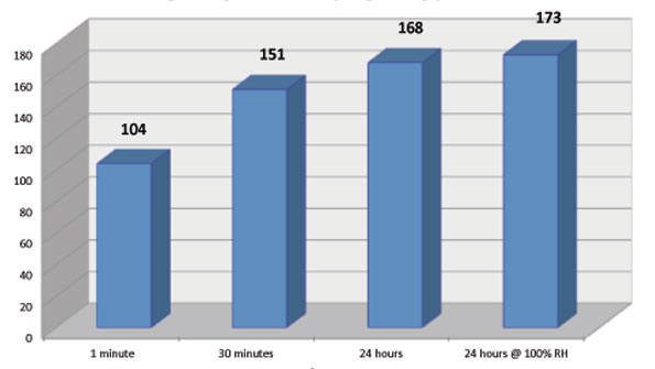

Figure 1. Tensile strength development of Carbophen resin.

Recent testing has shown that binder levels can be decreased to the lower end of that range with optimization of the core box venting, gas volume, and gas retention time. Optimizing these factors is critical to fast tensile strength development and somewhat dependent on the core geometry, which is where the venting comes into play. Typical tensile strengths over time are shown in Figure 1.
The tensile strengths have been found to be comparable to methyl formate-cured phenolic ester systems and sodium-silicate systems, allowing for use in a fairly wide number of applications from small vein cores to large, chunky shaped cores. Along with CO2 being a much lower-cost co-reactant, Carbophen becomes a good option for larger production runs, as well as job shop core- and moldmaking operations.
