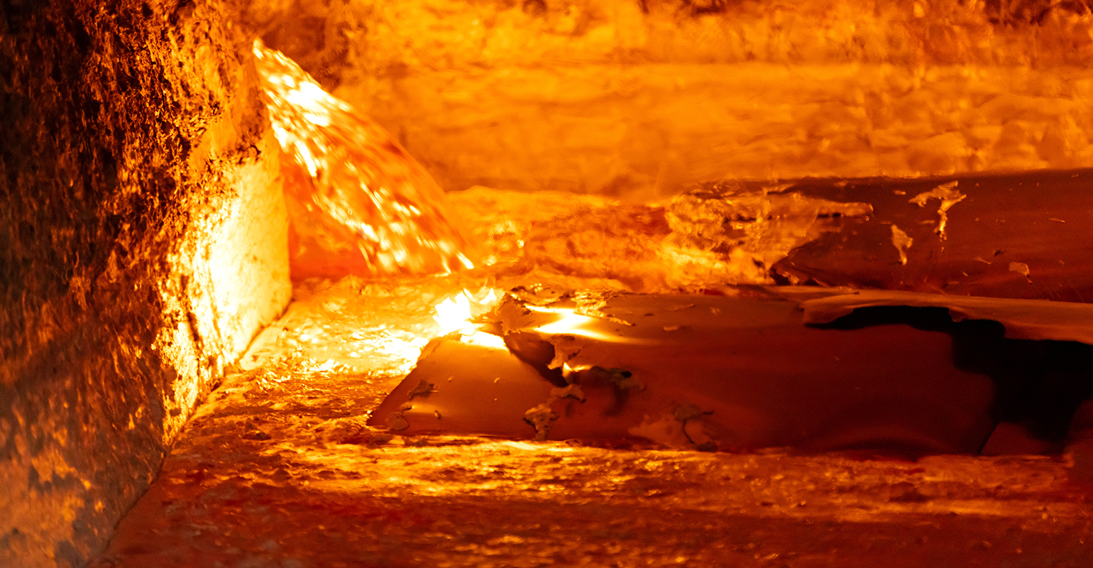

Aluminum melting in a reverberatory furnace.

This is my point: If you have radiant burners in the roof or electric elements in the roof of a holder or even a high headroom side fired melter molten-metal management is critical to their operation and efficiency. For example, if you draw your melters down 6-8 in. before refilling them, chances are they are no longer at the specified set-point temperature. Furnaces must work much harder to get the heat to the aluminum. The same thing to radiant roof holders. If you draw them down 5-6” before refilling them then chances are they will start to lose temperature.
According to the Stefan–Boltzmann Law of Radiant Heat, “the total energy radiated per unit surface area of a black body across all wavelengths per unit time (also known as the blackbody radiant emittance or radiant existence), is directly proportional to the fourth power of the black body’s thermodynamic temperature.” That is, the greater the temperature difference between your heat source and the media (aluminum) when there is a slight oxide film, the faster will be the transfer of BTUs into that load to the fourth power. Also, the closer they are to each other enhances that transfer. So, by limiting the draw down to a couple of inches, you can make furnaces run more efficiently and guarantee better temperature control. The best practice is, whatever metal you take out of a furnace in 15-20 minutes, replace with the same amount to bring it back up full again.
This is especially true with crucible furnaces. Although it may have less effect on efficiencies, it will shorten the bowl life. Crucible furnaces have extremely hot surfaces as heat rises up against the steel plate on top; when 5-6 in. of metal is removed from the bowl it is replaced with air, which is an insulator.
Electric Crucible Furnace
Now you have a build-up of heat at the top and nowhere to transfer it. There is a temperature gradient from the middle of the bowl to the top, which will crack the top of the bowl. Simply charging this crucible furnace evenly, so that the molten metal never is less than a couple of inches, may increase bowl life substantially.
