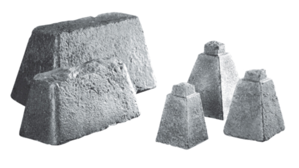

SMW insert™ can be used in different amounts depending on the trace element content in the iron. The recommend amount to be added is in the region of up to 0.2%. The inserts are available in different sizes, P 300 to P 30.

ASK Chemicals Metallurgy’s SMW Insert mold inoculant excels in this connection. The mold inoculation with the cerium- and bismuth-based SMW insert prevents chunky graphite by neutralizing disruptive elements.
A further advantage is that the inoculation process takes place without oxygen. Thus, oxide and sulfide formations, as well as oxidic impurities (e.g., slag) are minimized. The graphite degeneration is prevented due to the very late inoculation of the iron. This process ensures an optimal, uniform inoculation of the entire cast part during mold filling. The nodule count can be increased up to 400 nodules per mm2 and the nodule size reduced.
The mechanical properties, e.g. strength and toughness, are optimized depending on the wall thickness. Additional procedural advantages of the mold inoculant SMW insert are due to the ability to precisely calculate the required dose. The use of an additional metal stream inoculation device can thus be dispensed with.
Use of SMW Inserts— The SMW Insert can be used depending on the trace element content. The recommended amount to be added is in the region of up to 0.2%. The developer also recommends using the inserts in combination with the Germalloy mold inoculant, where the influence of trace elements is lower. For example, depending on the trace element content as well as for component-based reasons, the ratio can be 0.10% SMW insert and 0.10% Germalloy™ for an inoculant addition of 0.20%. All previously known P inserts, P 300 to P 30, also available as SMW Inserts.
The SMW Inserts can be used in combination with a preconditioning agent, e.g. VL (Ce) 2 and with a cerium-free and/or low-content-cerium FeSiMg master alloy, e.g. VL 63 O or VL 63 M 3. Small mold inoculation bodies should, in all cases, be installed in the pouring basin as "starters" – e.g. P 300, P 500 and/or P 800 – in order to ensure efficient and prompt inoculation. This will ensure that the cast iron that flows in first – which can solidify near the risers – does not have any chunky graphite and the inoculation effect is realized right from the start of the mold filling.
