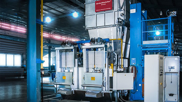

StrikoWestofen is installing the eleventh StrikoMelter system for CastAlum, at Welshpool, Wales.

The basis of the StrikoMelter system is a shaft geometry known as EtaMax, which uses hot exhaust gases from the melting and holding process to preheat the charge material — reducing the thermal energy consumption of the actual melting process.
“The extremely low material losses of less than 0.3% are repeatedly proving to be a significant competitive advantage for our customers in this highly competitive international market,” according to John Paterson, the manager of Striko UK. “After all, energy consumption and metal losses add up to about 95% of the total operating costs.”
At the diecasting plant in Welshpool, each of the fully automatic casting cells has a StrikoMelter furnace of its own, and the capacity and the volume of liquid aluminum kept ready are perfectly adapted to meet the requirements. The existing StrikoMelter furnaces at CastAlum melt not only ingots, but production returns too.
“The strategic structure of the system with individual casting cells ensures that it is always the same aluminum quality and alloy that is being handled,” according to Paterson.
