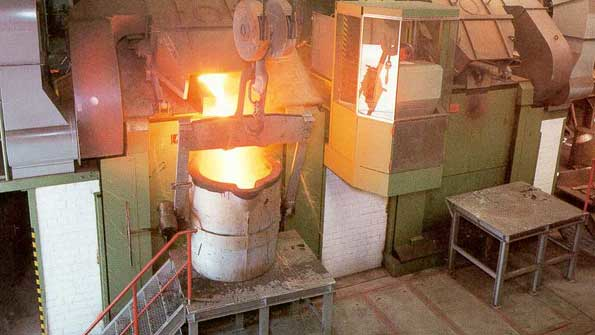

Galvanized steel scrap may be a source of iron units for foundries, and a source of contamination to refractory linings Diminishing electrical impedance Counteracting lining deformation Compensating in four steps
To improve corrosion resistance in automotive applications, a zinc coating is applied to steel sheet. While effective for its intended purpose, the zinc coating leads to problems when zinc coated scrap material is recycled as a base material for iron castings in foundries.
The ironmaking process requires some adjustments to minimize zinc contamination of the molten iron. For example, it helps to charge the zinc-coated steel scrap early in the melt cycle, allowing more time for the zinc to evaporate out of the melt. An extended melt cycle also may be necessary, to get the zinc concentration down to acceptable levels.
A significant problem with this approach is that the zinc also affects the refractory lining material, requiring some changes to the sintering procedure. It has been found that using zinc-free material for the sinter heat helps to reduce the amount of zinc penetration into the lining.
Zinc has a low melting point of 407° C and a very low vaporization temperature of 920° C. When zinc vapor is exposed to air, zinc oxide is immediately formed. As zinc-coated scrap is melted, the zinc is dissolved into the melt. At the free surface on the top of the melt the zinc vapor is exposed to air, where it oxidizes and combines with the slag layer that is removed before tapping the furnace. Some of the vapor is oxidized into zinc oxide dust, and carried away by the furnace exhaust system.

At the hot face of the lining the zinc vapor diffuses into the lining material. A matrix of metallic zinc and refractory granules is formed, which at the high temperature becomes highly conductive. Power is electrically induced into this area during operation, changing the electrical characteristics of the furnace.  The furnace behaves as if its lining is worn more than physical measurements would indicate. Some examples of refractory material contaminated by zinc are shown in Figure 1.
