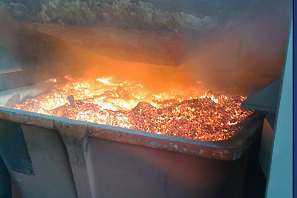

Batch melting creates more dross than continuous charging because it means more metal is exposed to oxygen.

Circulation’s effect on dross — The alloy remains constant throughout the furnace when properly circulated. Six to eight volume changes per hour is recommended. This will keep a uniform temperature in the furnace, which will result in less dross and oxides formed. The reason for this is that there is now no superheating of the metal surface, and the BTUs absorbed into the aluminum are distributed into the flow from the circulation, resulting in much lower surface temperatures (80-190°F.) It conserves metal and reduces dross, and saves maintenance and refractory costs, as well as energy loss.
Every metalcasters that produces dross should look at all the methods of recovering metal from that dross. There are rotary furnaces for large volumes, and dross presses that squeeze aluminum from hot dross for medium volumes of dross. For smaller dross producers, dross stirrers work well. These allow the furnace tender to place hot dross in a bowl and apply additional flux, and allow the unit to stir the flux into the dross, further reacting with the aluminum to remove it from the dross.
