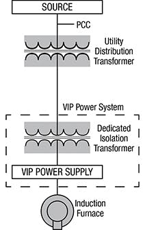

Total harmonic distortion (THD) is the ratio of the square root of the sum of the squares of the individual harmonics to the fundamental RMS value. THD is used to gauge utility line distortion. This standard and other international standards impose a limit on the total harmonic distortion of the voltage and current at the point of common coupling (PCC). The PCC is where the plant is connected to the utility line. Normally this will be the primary of the utility transformer feeding the plant, as shown in Figure 2.
