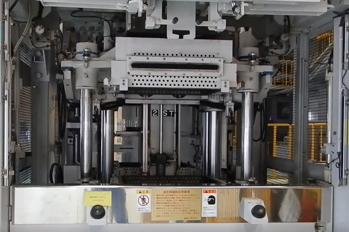

Today’s metalcasters face all-time-high capacity demands and existing technologies are not up to the challenge. There simply are not enough hours in a shift to produce what customers expect. Sinto understands this and is rising to the challenge with the new FCMX automatic molding machine. This is the first flaskless automatic molding machine to reach production speeds of 200 molds per hour, making it the fastest flaskless machine now available.
Not only will the FCMX machine run at 200 mph, but it will allow for 9 seconds of core set-time in the production sequence. The core-set during the machine cycle time is achieved by the action of a flask rotation mechanism, allowing the FCMX to compact the mold during the core-set cycle.
The machine design includes a station for molding as well as a station for operator interface for core-set. The increased speed equates to increased production capacity for foundries’ molding departments.
The FCMX is designed as a high-speed system with two or four stations for production, and capable of accommodating multiple pattern sizes. The process is integrated with the Sinto Smart Foundry digital package, which allows metalcasting operators to integrate all production systems into a single enterprise solution.
Sinto offers decades of horizontal molding experience to investigate and overcome the foundry capacity challenge – the FCMX can produce up to 200 molds/hour, with core-set – and it has invested significant amounts of time and resources to perfect the new machine, with 183 units now operating worldwide.
Mold quality and performance
The FCMX is capable of producing superior quality molds by applying aeration sand filling technology, along with a uniquely designed center-gravity support for the flasks. This allows for smooth separation during the pattern draw. In addition, aeration allows for consistent, evenly filled flasks, so it will provide sand to areas that may not get adequate fill on conventional machines.
FCMX also has a compact design that allows foundries to experience the speed and capability of this superior machine without taking up valuable floor space. The compact design provides foundries the ability to add multiple lines in an area that typically would be dedicated to a much larger system.
In designing the FCMX, Sinto has accounted for foundries’ existing patterns: it’s possible to transfer existing patterns from other flaskless style machines, and the FCMX pattern shuttle accommodates all other styles of Sinto molding equipment. With a simple pattern-adapter plate the FCMX can run competitor’s pattern plates, too. The FCMX has a squeeze counterbalance hydraulic circuit that will allow customers to use patterns that typically would not be run on an automatic molding machine.
The FCMX also offers the option of an automatic pattern changer. This will give customers the ability to stage a pattern in the auto-changer, and when activated by the operator the automatic pattern changer will initiate the pattern change within the cycle of the machine. The change will happen within the current cycle time of the molding operation, essentially removing the downtime of pattern change.
