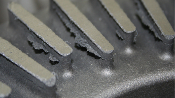

The effects of veining, visible in a brake disc.

Veining (aka, finning) has been a perennial problem for certain types of ferrous castings produced with chemically bonded sand cores. Engine blocks and heads may exhibit veins in narrow oil and water passageways that are difficult to remove, and could cause blockage and engine failure. Ventilated brake rotors may show veining in the “windows” that also are difficult to remove and could cause uneven heating and warpage of the rotor during use. Many different casting types with cored passageways and unfavorable geometries or sand-to-metal ratios can suffer from veining defects.

A brake disk casting showing veining defects (left); ASK Chemicals Miratec BD prevented parting line veining defects in the disk casting shown at right.

Veining Measurement — Two types of test castings typically used to measure the veining characteristics of different sand and binder systems are a step cone and a 2×2 (50 mm×50 mm) penetration casting. The level of veining is determined visually and given a numeric ranking of 1 to 5, with level 1 having virtually no veining and level 5 exhibiting very severe veining. The measurement method is somewhat subjective, but identifying the severity and location of the vein and using a weighted formula to calculate a veining “score” will provide additional quantification. Studies have shown that “the defect analysis technique was demonstrated to be a viable procedure as an evaluation tool in assessing foundry materials to prevent core-related defects.”
The 2×2 casting test provides an advantage in that four separate cores can be tested per casting, although cores are typically tested in duplicate to improve accuracy. It also seems to be somewhat more severe in that veins still appear in the 2×2 when step cone cores of the same composition appear free of defects.
