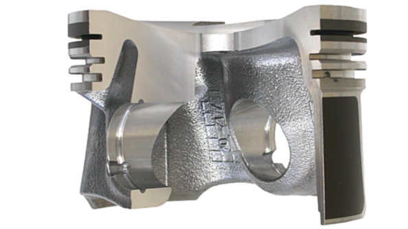

The Elastoval II is up to 20% lighter than the previous iteration of the piston series, with wall sections as thin as 2.5 mm. 'Any reduction in wall thickness requires the entire piston structure to be redesigned,' stated Arnd Baberg, chief engineer product engineering for Federal-Mogul Powertrain Energy, in 2012. The complex curved side panel forms of the piston are inclined in two planes and are closer together at the top to support the piston crown, using multiple weight-reducing pockets and crown reinforcing ribs. The piston pin bosses are curved towards the side panels and boss distance is reduced to the minimum possible. The design uses asymmetric geometries to maximize weight reduction.

The focus of the Qingdao expansion are Federal-Mogul’s Elastoval® piston products, which combine high-strength “piston architecture” with a low-friction, durable piston skirt coating. These products are designed with reduced boss gaps and a smaller distance between the side panels, which are angled or even multi-angled. In most cases, a convex boss structure is used, with optional weight-relieving pockets in the pin direction.
The Qingdao plant also will produce the newer Elastoval® II aluminum pistons, introduced in 2012. Announced then as an option for the European automotive market, to promote fuel economy and reduce CO2 emissions, the Elastoval II piston is reportedly 20% lighter than previous models, with wall sections as thin as 2.5 mm, compared with the 4 mm sections of the earlier previous design, and yet capable of increased power outputs and able to withstand the higher pressures that occur late in the combustion cycle of downsized engines.
