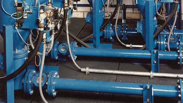

The battery of a Klein Plug Flo® sand transporter distributing sand for a large foundry.

A low-velocity sand-conveying system consists of a bulk sand surge bin; the blow tank assembly with controls; the standard Schedule 40 steel pipeline; one or more sand receiving bins with level probes and diverter pinch valves; the dust-collection system for the receiving bin(s); and a source of compressed air. During sand transfer the pipeline remains full of sand at all times, no additional air (boosters) is injected along the pipeline, and no air purge is required at the end of a conveying cycle, which allows the system to operate with considerably less compressed air than most conventional pneumatic conveying systems found in a foundry.

Blow tank assembly.  The operation of the blow tank or pressure vessel assembly is controlled by a PLC, normally using a single non-contact proximity switch to indicate the position of the sand outlet valve and a bank of solenoid air valves. Cycle times are set during start-up and monitored automatically by the PLC. A built-in cycle counter should be used to schedule routine maintenance for the various components as listed in the supplier’s maintenance manual.
After a certain cycle count is reached the sand inlet valve seal needs to be checked and replaced if wear is excessive. At the same time, all components in contact with the sand during operation need to be checked for wear, and replaced if necessary. Also, check for the correct seating of any proximity switches or level probes and inspect external wiring for visible damage. While inspecting the sand inlet valve seal, the inlet valve cone also should be checked for patterns of abnormal wear around the periphery, which would indicate a damaged seal.
