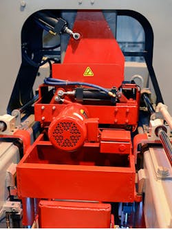

Possibly the most significant introduction is the HLM-10 molding machine: the company was established in 1964 on the basis of founder Al Hunter’s innovation in automated matchplate molding, and it has built and installed more than 1,800 molding machines and mold handling systems over subsequent decades. Now, according to company president and CEO Bill Hunter, the HLM-10 represents a new, proprietary concept in automated matchplate molding technology.
He said the HLM Series is the metalcasting industry’s first machine to integrate magnetically coupled rodless cylinders and linear bearings to move the squeeze platen, cope flask, sand measuring hopper and other components on the machine.
Formerly, the movements within automated matchplate machines involved cam followers, wheels, tracks, rails, and other mechanical parts that are subject to wear and require maintenance or replacement. But, Bill Hunter noted, “the HLM’s sealed linear motion slides and magnetic rodless cylinders replace these older components, to provide smoother, quieter and more energy-efficient operation with less maintenance and greater machine stability.”
He emphasized the new design would improve productivity for the automated matchplate molding process.
