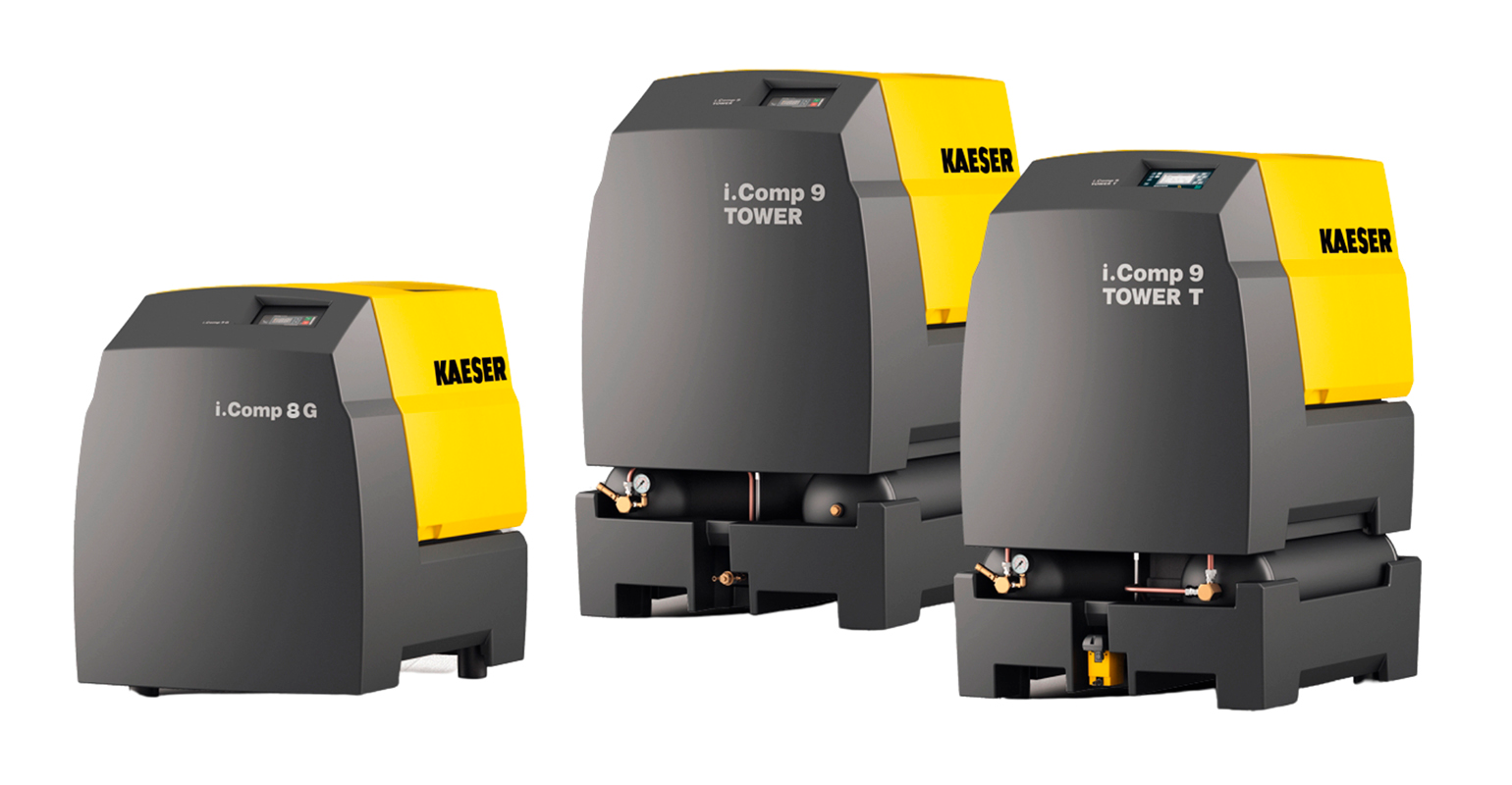

KAESER COMPRESSORS’ new i.Comp 8 and 9 oilless compressor series includes  two sizes and three configurations (G, Tower, and Tower T), and delivers oil-free air up to 160 psi and 20 cfm. These units are compact, quiet, and energy efficient. Further, the direct-drive motor and oilless design eliminates nearly all routine service.
i.Comp series compressors feature a reliable two-cylinder, single-stage oilless compressor with an integrated direct drive motor. Pressures can be precisely adjusted to each application’s specific needs with the proven Sigma Control 2 controller.  i.Comp compressors also are available as Tower configurations that include a receiver and drain trap, while Tower T configurations include a refrigerated dryer.
A small footprint and low noise make i.Comp ideal for small shops with tight spaces. The roto-molded, corrosion and impact-resistant polyethylene enclosure provides easy access to maintenance points, protects internal components, and limits sound levels to 65 dBA.
