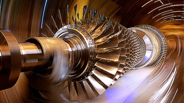

With production of industrial gas turbine generators rising to meet expanding global power demand, Morgan has established the capacity and technology to produces ceramic cores in support of investment casting for such parts.

MORGAN ADVANCED MATERIALS’ Certech injection-molded ceramics are specifically engineered for investment casting of airfoils and parts for industrial gas turbines: Morgan manufactures cores in a wide range of sizes and complex designs for equiax, single crystal, and directional solidification (DS) casting.
Critical airfoils required to withstand the high turbine-inlet temperature in modern gas turbine engines are investment cast in nickel and cobalt-based super alloys, with ceramic cores used to form the part's air-cooling passages. Morgan's ability to inject around quartz rods down to 0.020-inch (0.5 mm) in diameter has provided customers with the freedom to design features in the cooling passages that would otherwise be difficult to form.
