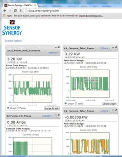

In the foundry, this real-time, monitoring equipment with 1-second resolution is deployed to measure and record the electricity, natural gas or compressed air that is used by the targeted equipment.   Raw data is collected, processed, and displayed in the foundry and also simultaneously uploaded to a cloud-based server, for viewing by other authorized stakeholders through standard web browser software.  To achieve energy and productivity improvements, measured data is analyzed in detail to identify trends and alert staff to out-of-normal conditions.

Tools within the viewer allow users to calculate total energy used for a selected time period and to compare energy-use profiles from different pieces of equipment.

Sensor Synergy’s browser-based data viewer allows all remote stake-holders with an Internet connection and a web browser to view data within one minute of the measurements. Tools within the viewer allow users to calculate total energy used for a selected time period and to compare energy-use profiles from different pieces of equipment.
Sensor Synergy’s Dashboard for in-plant staff provides data views with only one-second delay. Various tools within the Dashboard data viewer allow users to calculate total energy used for a selected time period, compare energy-use profiles from different pieces of equipment, export data files into spreadsheet compatible files, and more.
