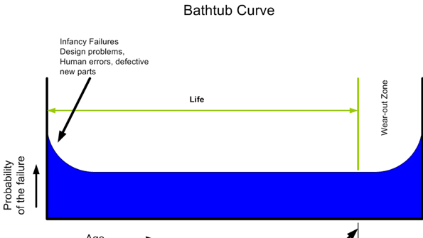

Fig. 1: The bathtub curve illustrates the likelihood of failure for foundry equipment over the course of its service life.

In many cases, time-based maintenance is not the correct approach to eliminating component failures. Often, equipment fails shortly after the preventative maintenance was completed. This is not the fault of the operators or the maintenance professionals, however, it can be blamed on traditional mindsets in the foundry business. For many decades, there has been a belief that all failures are age-related; in other words, it is commonly assumed that every piece of equipment has a useful life, and after the end of this life has reached, the equipment needs to be overhauled, or replaced.  This assumption still exists and Figure 1, known as a “bathtub curve,” demonstrates the frequency of age-related failures.
The bathtub curve indicates that at the beginning of its service life, the equipment has a high chance of failure; this could be understood as “start-up issues.” Then, it has an equal chance of failure for some time, and once the equipment reaches its useful life, the likelihood of failures increases, at which point it needs either to be replaced or overhauled.
In the early 1980s a comprehensive study of this concern was completed, but it never was adopted by many industries. The study showed that 89% of all failures in any industry are random incidents, and do not follow the bathtub curve. This was a revelation in many industries, and then it was realized that the traditional preventative maintenance is not effective for preventing random failures.
This finding holds true for foundries, too. However, most foundries still use the traditional time-based maintenance, which is why failures keep occurring even though the PM programs are completed.
