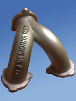

The finished part is a single part that confirms the validity of a metalcasting production process that incorporates 3D printing.
