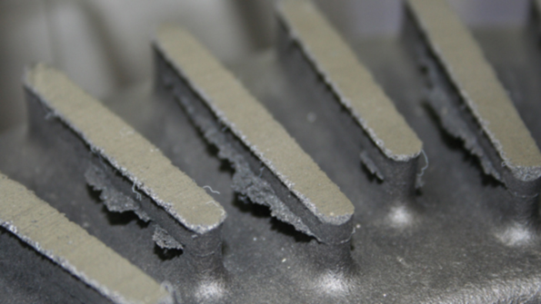

It’s important to remove veins that form, and it is especially critical to eliminate them in a casting’s internal cavities, such as in a water jacket, so its performance will not be impeded.
