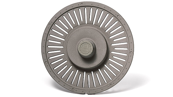

A disc brake core exhibits the degree of surface detail that influences how a coating should be applied ndash which is only one factor in the process of selecting an optimal refractory coating formulation

The properties of the coating during the application process must be suited to the application method. The most popular methods for applying a refractory coating are brushing, dipping, spraying, and flow coating. These methods differ greatly from each other in the coating properties required. Critical details like the rheology of the coating need to be taken into account when selecting the right coating for your application process. Brushing, for example, must flow without generating surface imperfections like runs and brush marks.  A coating used for dipping cores needs special rheological properties to minimize teardrops. Formulations used in a flow coating application must have sufficient flow to run off the core or mold, and not cause excessive teardrops or runs on the surface that lead to casting surface defects.
