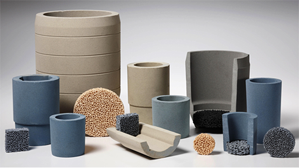

Pouring cups and reticulated ceramic filters ensure that metal is clean and enters the mold in a smooth and controlled manner.

How can these two goals be accomplished with one process change? Implementing a direct pour system can help to achieve this by reducing your metal consumption, while improving your casting quality. Eliminating gates and runner systems and adopting pouring cups reduces the amount of metal that is consumed. Pouring cups combined with the use of reticulated ceramic filter ensures the metal is clean and enters the casting cavity in a smooth and controlled manner.
Pouring cups come in many shapes, sizes, and formulas.  They can be exothermic or insulating, made from high-refractory alumina-based fiber, or core-shot alumina microspheres, and in any size and shape needed for your particular casting. Standard-size pouring cups are offered in 2- to 6-inches in diameter and 6- to 9-inches high, but other sizes can be produced for specific applications.
Filters also come in a variety of shapes, sizes, and formulas.  The size and shape needed is dependent on the pouring cup selected and the filter composition is based on pouring temperatures and alloy fluidity.
Iron and non-ferrous alloys may use silicon carbide, while steel alloys with pouring temperatures above 2,880°F will use zirconia and steel alloys; with pouring temperatures below 2,880°F, use carbon-bonded filters.  Zirconia filters are the strongest option, so if you have a difficult casting, zirconia is recommended.
