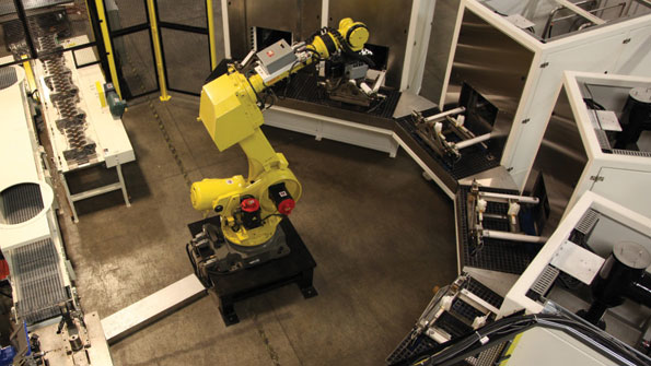

Today, a lean vacuum impregnation system is providing significant economic benefits for that Japanese OEM in the U.S. The Continuous Flow Impregnation (CFi) system, from Godfrey & Wing, was installed as part of the fully automated engine manufacturing line and seals (impregnates) a single aluminum cylinder block in less than 98 seconds. While the efficient cycle time allows for complete integration on the machining line, the effectiveness of this proprietary impregnation process has delivered a First Time Through (FTT) acceptance rate of over 99%.

The CFi system takes a single fully machined cylinder block straight from the production line and using a robot, automatically passes it through a four-stage vacuum impregnation process. The process components are a Dry Vacuum Pressure (DVP) impregnation chamber using a low viscosity sealant, a centrifuge to recover surplus sealant, a water wash/rinse stage and a hot water cure stage to solidify the sealant inside the casting porosity.

Capable of operating 24 hours per day, seven days per week across three shifts and producing over 220,000 cylinder blocks per year, the CFi is an integral part of the OEM’s operation.
A feature of the CFi system is the ability to process singular parts such as cylinder heads, blocks, transmission cases or trays of smaller parts such as fuel injection pumps, air conditioning compressors and power steering housings in just a few seconds. This benefits handling and a seamless integration with other manufacturing operations, as well as requiring significantly less floor space than conventional impregnation systems.
