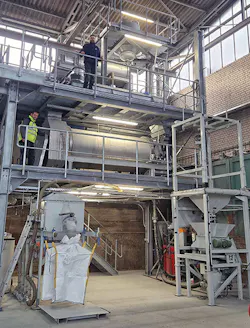

Last year a German business, FSP Foundry Sand Processing, commissioned a pilot plant for wet-reclamation of inorganic-bonded sands, and makes it available to foundries for testing their own sands’ suitability for recovery. The Stuttgart, Germany, plant performs a wet reclamation process patented by DEANTEC GmbH for “water-glass bonded” (i.e., sodium silicate) foundry sands and special sands from 3D printing processes. It’s described as “highly energy-efficient and close to carbon-neutral” process with a throughput rate of one metric ton per of sand per hour.
The sand is not dried with heated air; rather, water is converted from liquid to gas using energy recovered from the condensation stage. Dust particles are removed in a patented fluid-bed cooling separator.
Process water is treated and maintained in a closed circuit. One metric ton of sand generates just 12 liters of wastewater, which represents the only freshwater requirement. Because the distillate is fully demineralized, it is better suited to washing the sand than fresh water.
Also, during the distillation process, condensation energy is recovered. Nearly all (95%) of the energy required for evaporation is recovered from condensation.
FSP’s process removes contaminants from used sands with 98% effectiveness, so the reclaimed material will have nearly equal mechanical strength and flowability as new sand. According to FSP, this means foundries can use it to fulfill up to 95% of their “new” sand requirements.
Compared to mechanical sand reclamation processes, the FSP process is claimed to be gentler to the material. Binders are removed without damaging the grains, and the process is practically dust-free. The fine-grain fraction of the reclaimed sand is less than 0.3% percent, according to FSP, meaning there will be no additional costs for dumping spent sand.
