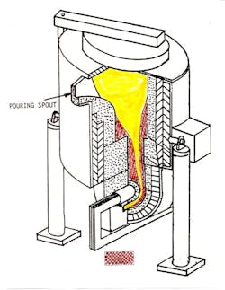

Slag build-up usually manifests as a deposition of low melting oxides, silicates, and sulfides on the side walls of the furnace refractory that reduces furnace capacity. But more important, build-up in the critical inductor loop in channel furnaces can be very harmful. It is critical that this loop of molten metal be continuously maintained. If this loop is allowed to freeze, extreme care is necessary in remelting because the loop may rupture and disrupt the circuit. The relatively narrow melting loops or channels must be kept as clean as possible.
An example of slag build-up on upper case sidewalls, and in the inductor loop and throat areas is shown in Figure 1.

The following example illustrates how Redux EF40 flux additions can improve melting efficiency and provide significant downstream melting cost reductions. Foundry “X” was experiencing extensive slag build-up on the upper sidewalls of two 65-ton vertical channel holders. Each channel furnace upper case was lined with a silica refractory while the inductor was lined with a dry-vibratable, alumina-magnesite refractory.
The condition of the channel furnace uppercase after 11 months of operation is shown in Figure 2a. After 11 months of operation from a newly relined furnace, slag build-up reduced the working furnace capacity to less than 35 tons. Build-up was so severe that adhering slag was over 15 inches thick and extremely tenacious in clinging to the furnace walls. The slag build-up was nearly impossible to remove during routine weekend maintenance. The build-up was also responsible for clogging the inductor loop and reducing the working diameter from 12 inches to barely three inches (see Figure 2b.) At this point, the furnaces were typically relined.
