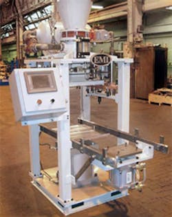

EMI’s new core machine is a pneumatic design with an air-over-oil circuit, a 75-lb blow capacity using an 1818-inch blow plate, new tooling, and a drag roll-out cart with an external ejection system. Equipment Merchants ...

EMI designed and manufactured a new R&D machine with motions that could be run automatically for further testing. The result is a pneumatic machine with an air-over-oil circuit, a 75-lb blow capacity using an 1818-inch blow plate, new tooling, and a drag roll-out cart with an external ejection system. EMI made a set of tooling based on a two-part mold for 505 test bars, and also incorporated some stock equipment and used a batch mixer, scrubber, and a 4-kW gas generator for testing.
