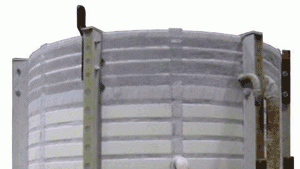

Three things will prolong the life of an induction furnace coil significantly and minimize furnace downtime:
• Buy the best melting equipment available for your application;
• Select a proper refractory, install and sinter it carefully; and,
• Schedule regular furnace and refractory maintenance, and perform it rigorously.

In particular, Stevers cited the furnace coil’s heavy copper tubing, durable Inducto-Flex® coil insulation and the strong furnace structure. “The heavy copper tubing is locked into position by the rigid coil supports and surrounding furnace steel shell,” he explained. “This keeps the coil from flexing and losing its shape. Also, the tough insulating coating on the coil helps to protect it against arcing. I’ve always had excellent service life from Inductotherm coils and the new Inducto-Flex insulation has enhanced their trouble-free operation.”
“When you start with the best furnaces, you need to keep them in shape by providing the best lining material for your application, installing that refractory properly and sintering it according to specification, no shortcuts,” he continued. “At Metaltec we use a proper lining form vibrator system to compact the refractory material completely and to ensure there are no voids. This works very well for us, and I can be sure the same results are achieved no matter who installs the lining.”

“We perform a visual inspection of every furnace at the beginning of each shift,” reported Stevers. “We tighten the tie rods as often as needed or if the inspection indicates that they may need to be tightened. The major thing we look for during daily inspection is any difference in the top cap that would indicate that a tie rod had come loose or had broken. We have found that if the top cast ring is held in place, the coil tends not to grow and affect the integrity of the coil.”
He also said the shunt bolts are checked and tightened if a significant change in the furnace sound is apparent.
