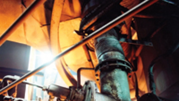

As the percent of oxygen in the cupola increases, the percentage of nitrogen decreases, the flame temperature and available heat increase, and the heat transfer rate increases, all leading to more efficiency.
The APCOS oxy-fuel burner uses natural gas, substituting heat energy supplied by foundry coke, and reducing coke consumption by up to 40%.

In the early 1990s, Air Products introduced its patented APCOSTM (Air Products Cupola Oxy-fuel System) oxy-fuel burner for cupolas. APCOS allows simultaneous injection of natural gas, oxygen, solids and metallurgical powders through the cupola tuyeres. At the time of introduction, there were three main objectives desired using APCOS: increased fuel efficiency through the reduction of coke consumption; the ability to increase and decrease melt rate quickly; and the ability to inject solid materials without the associated cooling effect. These objectives remain the same today, however now the focus is on increasing the efficiency of the cupola and decreasing the overall cost of operation. Of utmost concern is the increasing cost of foundry coke coupled with declining coke quality and limited availability.

The APCOS oxy-fuel burner uses natural gas as its fuel, substituting heat energy supplied by foundry coke. Natural gas is one of the most abundant fossil fuels in the U.S., the distribution system is well established, and the current price is low compared to foundry coke. In fact, the price of coke is four times that of natural gas in some markets (evaluated on a $/MMBtu basis). Foundries that have used this technology have been able to reduce coke consumption by up to 40%. This makes APCOS a very attractive option by providing significant savings and quick paybacks.

Finally, the system is very flexible. The oxy-fuel burners are equipped with supersonic oxygen nozzles. This allows the foundry to shut off the natural gas and still be able to enrich through the tuyeres. Also, the burners are designed to be installed and removed easily if maintenance is needed on the tuyeres.
