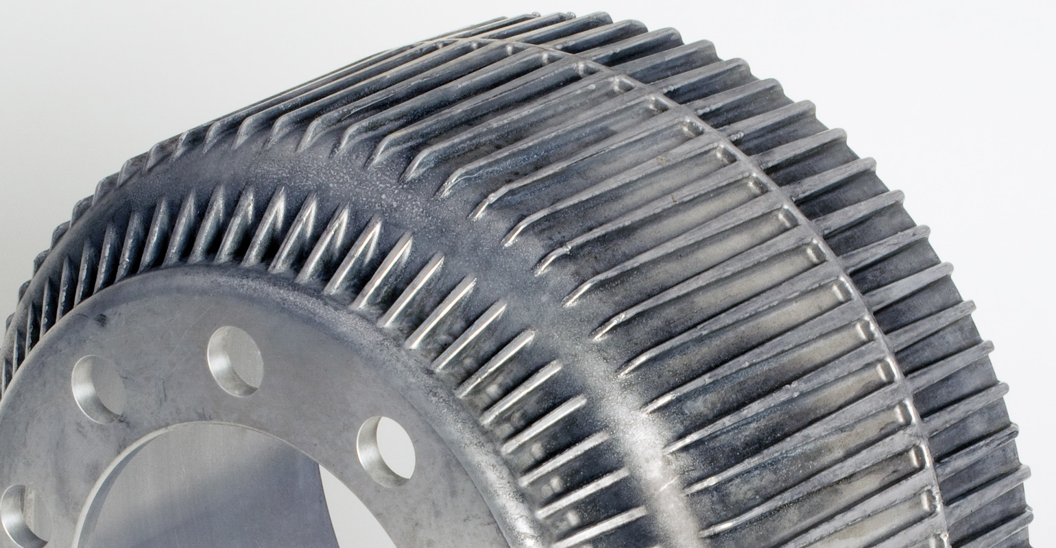

Automotive cast parts.
Accuride
Gunite MMC rear-axle brake drum
