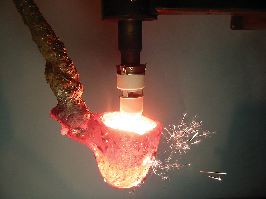

Stockholm-based SinterCast licenses a process control package used by foundries to produce compacted graphite iron (CGI), a lightweight cast iron that offers greater tensile strength, stiffness, and fatigue strength than gray iron or aluminum. The series production of CGI mainly involves diesel and gas engine manufacturers seeking to reduce weight, noise, and emissions for their designs.
SinterCast’s CGI process control system is centered on a sampling and testing technology that has been licensed by numerous foundries and research centers worldwide.
