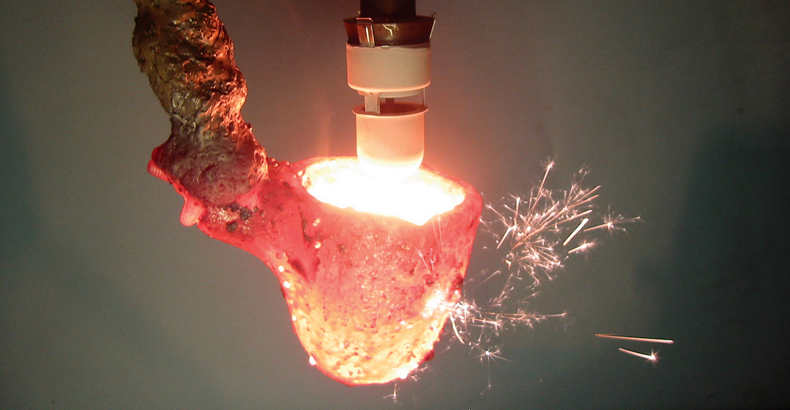

SinterCast sampling cup during compacted graphite iron refining.
