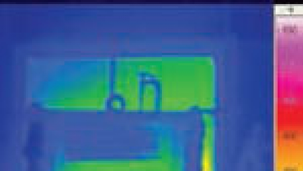

An IR camera detects hot spots or other problems with the furnace lining.
Furnace lining repair material can be pumped in from the outside to fill a hot spot and cool a particular area.
An efficient furnace lining is essential for reducing overall maintenance costs and ensuring that facilities run smoothly, without unwarranted revenue loss due to downtime. Follow these tips to keep your furnace running efficiently.
Tip 1. Evaluate the furnace liner with IR thermography inspection — Infrared (IR) thermography scans are essential for evaluating the quality of the furnace lining. Lining quality is critical to protect the steel from excess heat and limit heat loss, and to promote overall furnace efficiency. Typically, the scan involves pointing an IR camera at several points on the furnace casing to analyze the outside temperature and identify hot spots where the unit is leaking heat or experiencing design issues that may not be visible from the outside. This is a particular issue with a painted surface.
Obviously, scanning from the outside is of great benefit because the furnace unit can continue to operate. In many cases, specially trained applications engineers conduct the infrared imaging, analyze the IR scans, and provide recommendations on the most appropriate repair options.
