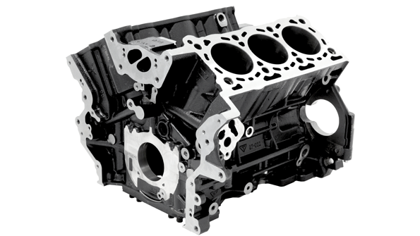

VM Motori a FiatGeneral Motors joint venture that manufactures diesel engines is a SinterCast licensee producing blocks and cylinder heads for several commercial vehicle programs

SinterCast detailed that second quarter production was marked by continued strong performance of Audi and Ford V-diesels in Europe, and by the start of production at VM Motori for V-diesels destined for the Jeep Grand Cherokee SUV and Dodge Ram 1500 light duty pick-up.
