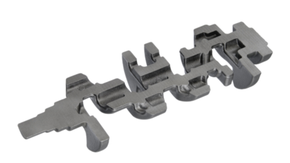

Automotive cast parts.
GF Automotive developed the SiboDur alloy to offer both hardness and ductility making it an effective choice for casting automotive driveline parts like crankshafts as well as chassis components like steering knuckles and suspension and steering system parts too

SiboDur is a proprietary cast iron grade named for its particular combination of silicon and boron alloys, and for the durability that results by the alloy combination that achieves both hardness and ductility. GF developed the material and introduced it more than five years ago, for automotive crankshafts as well as structural components for chassis.
“It allows a much lighter construction of chassis parts in iron and competes successfully with aluminum and steel forgings in terms of performance and weight at a lower cost,” the group stated.
GF Automotive produces castings with SiboDur at two iron foundries in Germany, and it has licensed it to Grede Foundries for production in North America.
