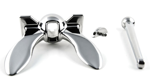

Fimbinger GmbH, an Austrian specialty machine builder devoted three years to designing and developing the Seahawk SHHP Anchor®. In some parts of the shipbuilding industry, a three-year development program may not seem out of line. This anchor combines exceptional design with high functionality, and bests other models available not only with its high-quality processing but also with its lower weight (and therefore lower cost), as well as its higher holding power.
One important detail about the newly patented anchor is that it consists of just three parts — two castings, one forging, and no welds.  The forged and turned anchor bar, secured by a crescent with two locking screws, is simply inserted into the cast anchor blade. With this novel, construction, the anchor can be dimensioned 25% smaller than in the conventional design. That innovation saves weight as well as material and production costs.
