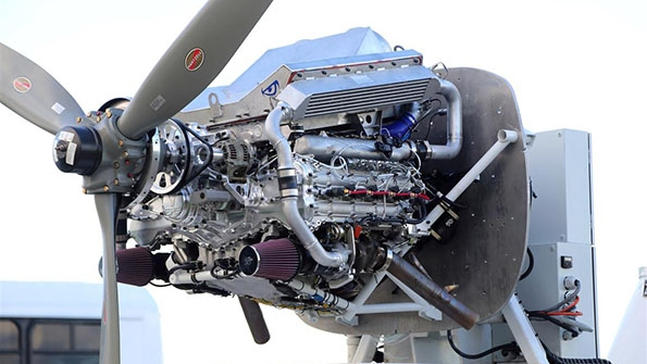

Engineered Propulsion Systems
The 43liter eightcylinder ldquoflat Vrdquo engine developed by Engineered Propulsion Systems is a compact block that draws on compacted graphite ironrsquos lightness and stiffness to complement its lowprofile design to maintain low aerodynamic drag and improve fuel efficiency

A Wisconsin-based aircraft engine builder is introducing a diesel engine cast in compacted graphite iron, drawing on the material’s “strength and stiffness” to set new performance standards for general aviation. Engineered Propulsion Systems, New Richmond, WI, also credited the engine’s ‘flat V’ design in setting that standard.
The 4.3-liter, eight-cylinder engine is a compact, low profile package described as easy to install, durable, and maintaining low aerodynamic drag. The engine is intended for use in single and twin-engine aircraft, small helicopters, and unmanned military aircraft. Some marine engine applications also may be possible, according to EPS.

According to EPS, using CGI allowed the designers of the Graflight aero diesel engine to take a “clean sheet” approach to the project. Initial flight tests indicate the engine has a specific power of 105 horsepower/liter (77 kW/l), resulting in a total power output of 450 hp (332 kW.) The installed weight of the engine is just 45 lb. (20 kg), as compared to a 350-hp (257-kW) air-cooled turbocharged engine that would be a typical alternative for general aviation programs.
The Graflight aero diesel is further promoted as potentially more fuel-efficient than any general aviation engine currently available. “The diesel combustion process, together with the design freedom provided by high-strength CGI coupled with steel pistons, enable EPS to realize 30-50% lower fuel consumption and emissions compared to conventional aero engines,” according to a statement issued jointly by EPS, SinterCast, and Grainger & Worrall.
