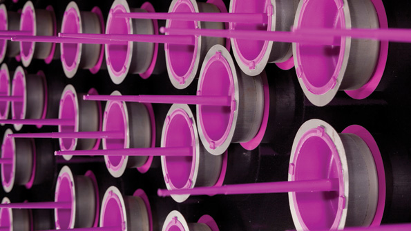

Sample parts made of zincplated steel and a customized biobased polyamide called Vestamidreg Terra were injection molded and adhesively bonded in a single step using an adhesion promoter called Vestameltreg Hylink

MMCs may seem novel in a commercial sense, but as an industrial technology it is comparatively mainstream. Two years ago researchers at Germany’s Institute of Plastics Processing (IKV) successfully combined injection-molded plastic and metal diecasting in a single process step.
Now, another process has emerged combining metal and plastic forming. Specialty chemical producer Evonik and IKV developed and commercialized a process for deep drawing and diecasting metal parts in a single, automated operation, using Evonik’s Vestamelt® Hylink copolyamide-based adhesion promoter.  Subsequently, to improve the parts’ mechanical properties after conditioning, Evonik is offering bio-based Vestamid® Terra polyamide and polyphthalamide molding compounds, focusing on establishing finished-part characteristics that address demanding requirements for temperature or chemical and moisture resistance.  As with current MMC cast parts, the applications determine the choice of forming process – but increasingly the materials are not determining the limits of production. The function determines the material and the method.
