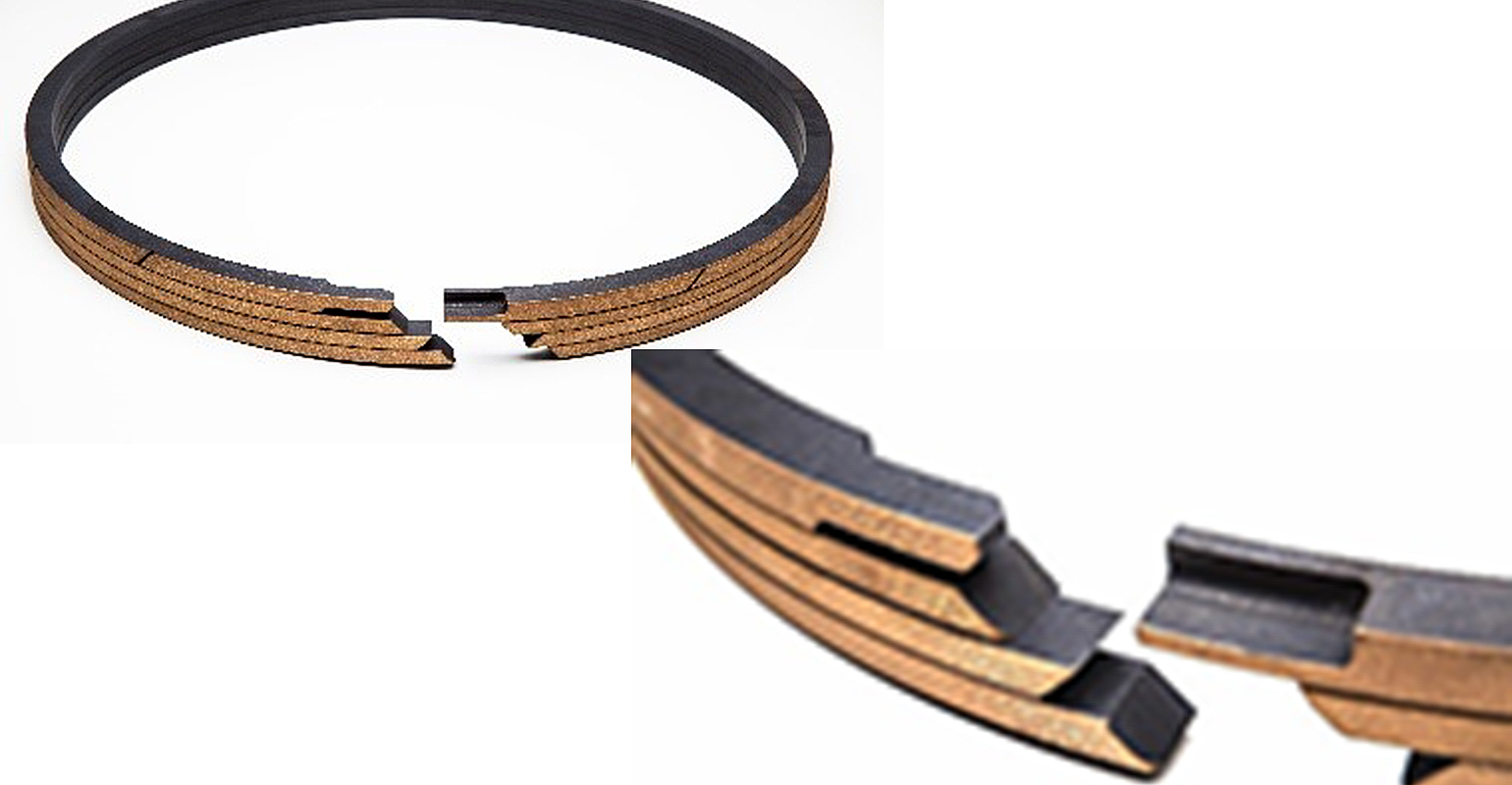

A South Korean foundry, Total Solutions and Power Company Ltd., launched series production of compacted graphite iron piston rings for industrial engines, using the SinterCast technology for CGI production. The rings are produced at a plant in Yang San, for engines with cylinder diameters from 300 to 700 mm.
“Following the initial installation of the SinterCast Mini-System 3000 at the TSP Foundry in 2011, we are pleased that TSP has been certified by MAN Diesel & Turbo SE as a supplier of CGI piston rings for industrial power engines, and that initial niche volume production has begun,” commented SinterCast president and CEO Dr. Steve Dawson.
He said the start of production at TSP presents the opportunity to produce piston rings beyond the initial diameter range, and for other CGI marine products to be developed and launched there.
In the past, CGI has been used only top piston rings, to achieve better endurance from high thermal and compression loads. TSP will be supplying CGI rings according to an engine design by MAN Diesel & Turbo SE in which the standard four-ring arrangement (one made in CGI, three in gray iron) is replaced by three CGI rings.
